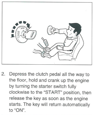

    hello. i'm a newbie dmax owner so please bear with me.
    i have two questions.
    1. i read sa manual you have to step on the clutch before starting the ignition (even if the pickup is on neutral). is it really necessary?
    2. when starting daw a deisel engine like dmax, we have to wait several minutes for the engine to get warm before driving it? how long exactly? and gaano katagal di napa andar ang pickup before performing this 'ritual' again?
    thanks talaga sa tulong and sorry if medyo 'dumb' ang mga questions ko. if there are also links to websites na me tips how to take proper care of my dmax, i'd really appreciate it.
    First, welcome and congratulations! Always remember na walang maling tanong and this is what this board is for. Now to answer to your queries:
    1)
    Not necessarily. I'd say it is suggested in the Owner's Manual to address the general market as an added safety step prior to starting the vehicle. (assuming tranny is engaged and not in neutral)
    2) Yes, normal operating temp is expected to be reached in around 5 minutes from starting the vehicle. In the event that you need to immediately depart, make sure you do not exceed 2,000rpm until you reach the normal operating temp.

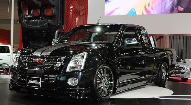

    *Benzmizer: That's one shiny pickup. I have posted that picture too some months back that I got from autoindustriya.com
    for no. 1 - this is practiced to reduce the drag on the starter when you start the engine. but in my opinion. as long as you check that the tranmission is in neutral then you don't have to step on you clutch here in the philippines setting. probably unlike other countries were it's cold or snowing. the oil and gear oil may become thicker. therefore more drag.
    no. 2 - you don't have to wait 5 min to drive your car out. but as mentioned earlier. be easy on the pedal. 1-2 mins is fine. this is just to make sure that your oil pressure is up. and that oil has completely circulated inside the engine. again due to our climate being tropical. it does not take much time for the engine to heat up. unlike colder climates.
    most important is to know the oil raitng you need for your engine. with my wife's fuego. it states to use oil rated cd. i'm sure for your engine the recommended oil is rated at cf or cf-4. you will see this on the back of the oil container. so the next time you buy oil. check the rating behind. cheapest oil now a days is rated at cc. this is for older engines like the ones passenger jeeps use. next is cd, cf, cf-4 and the latest is cg.
    hope this helps:-)
