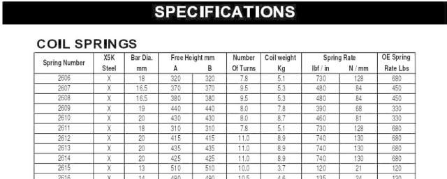

    84N/mm as per OME2607, idk how that compare to the stock i just need to correct the camber. Plan B would be the spacers, or it could be just the rubber bushings. Buti nalang i have the parts ready in anticipation sa pagpalit to nitro shocks na hindi ko na tinuloy. Ayaw masira nun OME N183S, pang disyerto yata talaga design nun
    From memory OME 2607 are medium duty springs, a bit stiffer than stock. 79N/mm? yata yung OE.
    Have you also replaced the hub bearings?
    Mababago kaya spring rate kung spacers? Ang goal ko lang naman ay maayos yung camber para pantay kain ng goma.

    Bro, if the spacer is between the coil spring and the coil bucket the spring rate will increase as the spacer thickness increases. Too thick a spacer will also cause UCA contact with the coil bucket.
    If the spacer is the one that goes on top of the coil bucket the spring rate is the same. But it will increase down travel and might cause cv and ball joint binding.

    I should correct myself, with the spacer in between coil bucket and spring the spring rate is the same but the preload increases the thicker the spacer. This precompresses the spring and limits up travel.
    The other type of spacer reduces down travel and might cause damage to other components.
