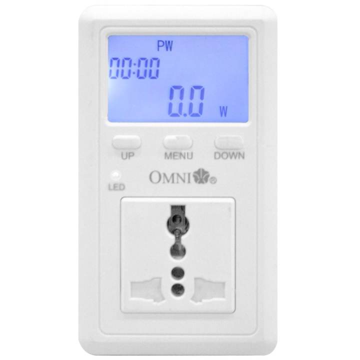

    If still in doubt, bili ka nito. Sa ace ata meron or sa lazada.
    https://ph-test-11.slatic.net/p/3/di...720x720q80.jpg
