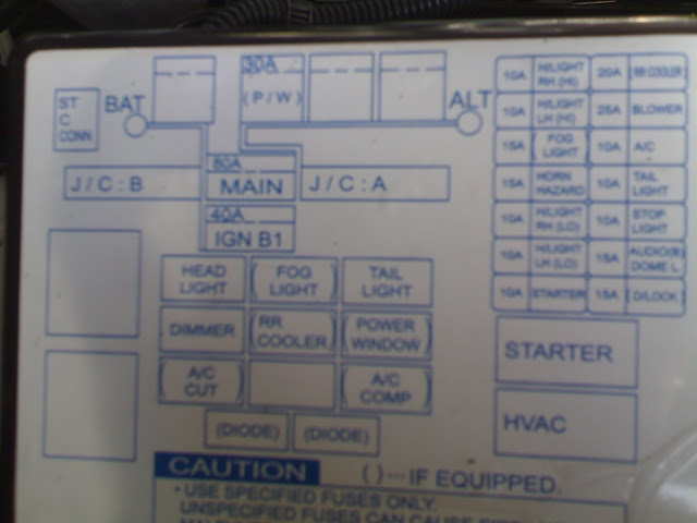

December 18th, 2009 11:58 AM #22
thanks benchao!
i guess i just have to have my ride checked by an electrician.
i tried interchanging fuses and relays and nothing seems busted...
to no avail, i can't make my dim light work .
yun lang kasi hirap minsan o madalas. a little problem can be a costly one pag yung nakuha mong gagawa eh nagmamarunong lang pala o mangagancho.
questions:
-can't the foglamps be switched on solo? what i mean is, do you have to switch on the headlights to be able to make them (foglamps) light?
-i'm currently using my foglamps as an alternative for my lowbeam since they aren't working. will constantly using them bring harm to my car or to it's electricals?
oh Lord, please make my dim light shine!
salamat ulit sa sagot at sa mga sasagot!

December 18th, 2009 12:43 PM #24Doesn't have relay? It's immpossiblethat 2001 xto or any vehicle doesn't have relay for the headlights. This flyby night filipino mechanic always said this which is WRONG. There is poa relay please see your owners manual. Kindly check the grounding of your headlight. Or have the steering wheel be removed and check contacts & wiring of the controls.
Verified Tsikot Member
- Join Date
- Nov 2009
- Posts
- 87
December 18th, 2009 12:53 PM #25It's clearly visible po down the IG B1 1. Headlight on the lower portion dim. Next somewhere on the right side & itaas there is the headlight RM LM marking 4 po iyan. yan po ang mga ipa check kung ok. Then kindly have the headlight groundings be checked. Then if ok ang headlight grounding sa manubela, yung control wiring and contacts
- Join Date
- Nov 2009
- Posts
- 87
December 18th, 2009 12:58 PM #26Electrician po who knows how to use electrical tester and knows how to troubleshoot & analyze the problem. Not just inorder to lit your headlights they'll run another wire and putting a relay sales talk ika nga po. Ayun nagkaroon ng sphagetti wiring na mga cars nyo. Let them troubleshoot and don't allow them to run another wire just for the sake na magkaroon lang po ng ilaw

sa wakas umilaw na rin yung dim light ko!
yun lang naubos oras ko sa banawe sa katitingin sa mga relay ng mga walang alam na electrician kuno, di rin pala nila magagawa.
at nagtyaga akong lakbayin ang madilim na landas ng san pablo laguna noong 24 ng disyembre. gamit lamang ang aking fog lights at high beam na kinakainisan ng mga sumasalubong!
sa probinsya ko pa napaayos c/o my wifes brother. sa switch lang pala may kaunting deperensya.
ayaw bumaba ng todo.
