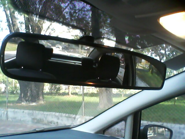

    Wide angle rear view mirror. Sentimental value na sa kin to dahil mula sa 1982 Tercel, 1996 Toyota Town Ace, 2002 Honda City an ngayon Ford Fiesta.
    Notice kita mo buong interior at bawas blind spot. From the driver seat you can see both driver and front passenger windows. Even looking forward you can feel the space around you. I highly recommend it. Pang truck yata ito o sa mga UV, dahil sa Concorde wala ako makita kamukha.
    Eto naman "interim" splatter guards. Habang hindi pa ko nakabili ng custom para sa Fiesta. Kahit dry season pa lang kung minsan may putik din sa daan. Not to mention animal digestive output . (We live in semi-rural area and I drive to urban destinations. Even City of San Fernando Pampanga still has calesa)
    I've installed them in a way madaling palitan if ever.
    I cannot claim any porma, purely utilitarian. Got them for P400 at Concorde SM Pampanga.
