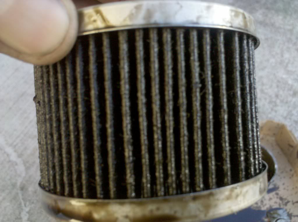

    Both will get the job done as far as filters go, the Mobil 1 filter is a mixed media filter like the Baldwin, The fleetguard will have more pleats and hold more dirt as they are designed for fleet service.
    Basically they just copied what Fleetguard and Baldwin have been doing for years.
    The Mobil one has a better higher efficiency rating than the fleetguard being absolute at 20 microns the fleetguard is absolute (98.7%) at 25 microns.
    The mobil 1 fitler is also physically smaller than the Fleetguard giving it less pleats and less overall filter surface.
    Mobil1 M1-104
    OD 3.14 (80mm)
    Height 3.08 (78mm)
    Fleetguard LF3462
    Overall Height: 81.79 mm (3.22 in)
    Largest OD: 84.07 mm (3.31 in)
    Mobil1 main issues they tend to make their filter element smaller than most others. Here's your filter in Mobil1
    So I guess it would come down to price and availability. You would be better served with a better oil than their 0w-40 oil, it's pretty light in the additives. This oil does not have a high TBN and pretty weak zinc and phosphorus. I would use their TDT diesel oil. It's perfect for all cars because the ZDDP level is right at 1200ppm.
