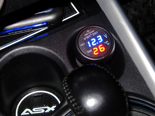

    11.90V is approx. 40% battery power. Nag-start ba engine? If not, then need i-charge ang battery. If yes, no worries. Mag-charge ulit ang battery when you drive the car na.
    Sent from my D5833 using Tapatalk
    wala naman problema pag dating sa starting. pumapalo sa mga 13-14 volts kapag naka start ng iyong auto.
    pareho pala tayo ng volt meter cum thermometer na gamit bro
    54,219
    #1252
    the 11.9 volts is the battery's innate voltage. but as all voltmeters have an inherent +/- accuracy value, say, 10%, the actual voltage can be anywhere between 10.71 volts to 13.09 volts.
    once the engine starts, the 13-14 volts measured is actually the alternator's output and not the battery's.
    how can you get a more accurate reading? get a more accurate, usually also much more expensive, voltmeter.
    Check mo rin ang voltage after you use the car and switched off the engine. Just enable ACC para magka-power ang 3-in-1 voltmeter mo. Then you will know kung nag-charge ang battery mo during your drive.

    Quote Originally Posted by red_one View Post
    I recommend using in-car voltmeters para pwede ma-monitor ang battery power when engine off and engine on. This one is multi-function. It also serves as thermometer and USB charger.
    Nice gadget plugged only to the cigarette lighter. Which temperature is taken into and how much po i see one in Lazada. Thanks.
