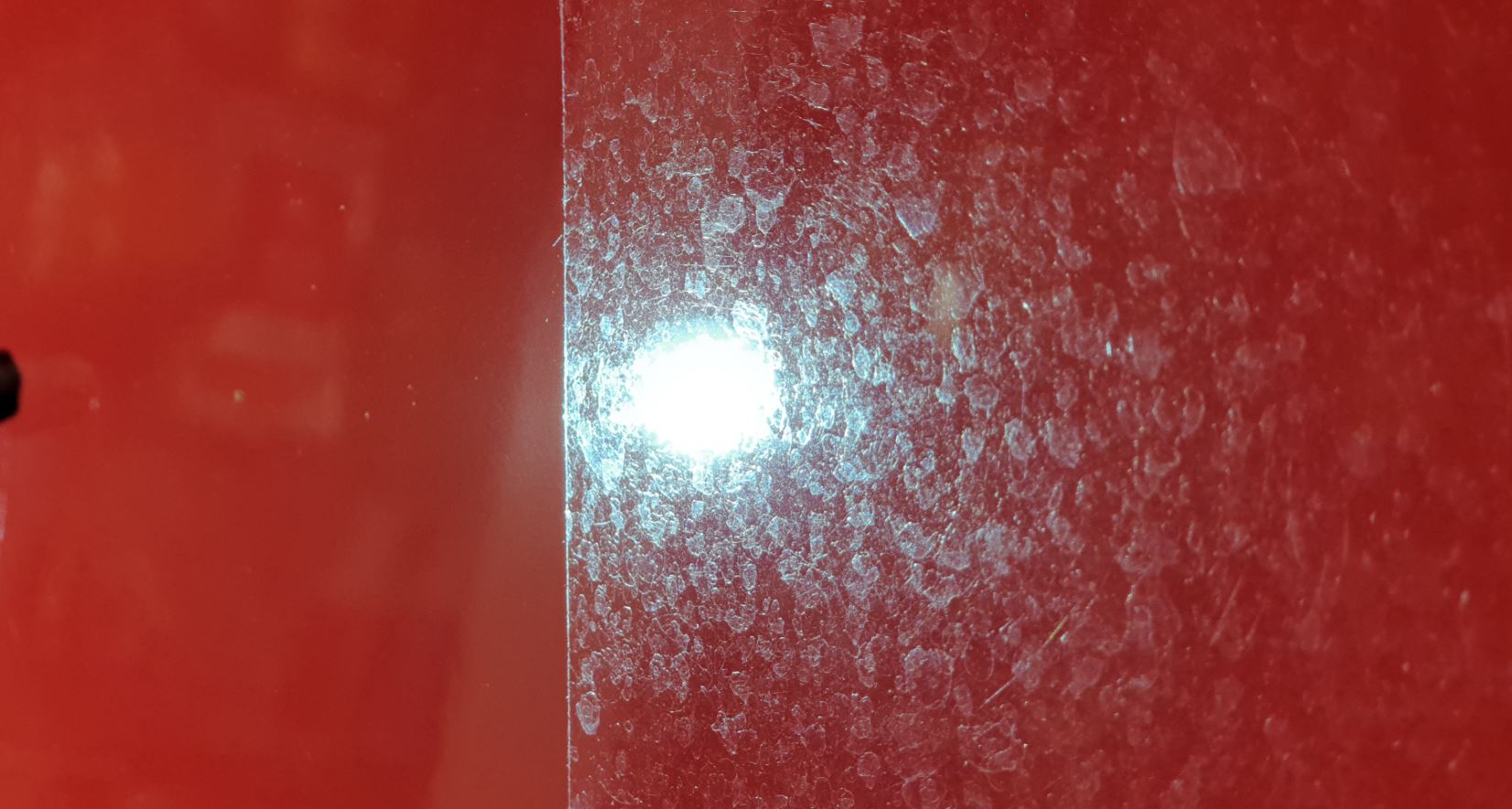

    Did a clients car a few weeks ago. Heavy watermarks on almost all exterior surfaces.
    Rough cut using Megs M100 and Rupes Coarse Wool.

    Yes to refine paint. If you look closely a lot of haze on the compounded area.
    Ah m205...haha still not finished compounding. Daming panels pa. I think I will be doing the roof and front rear fenders today.

    Just finished compounding. Next is m205 to refine and make the paint pop. I think that would be easier. Haha Im thinking what would I use for LSP.
    Although some etching I cant remove na with megs UC. Need a stronger cut product pa siguro.

    Megs Ultimate Compound plus mf pad. Not perfect though. Mas maganda ung results pag Carpro Ceriglass and rayon pad. Mahal nga lang.
