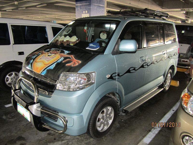

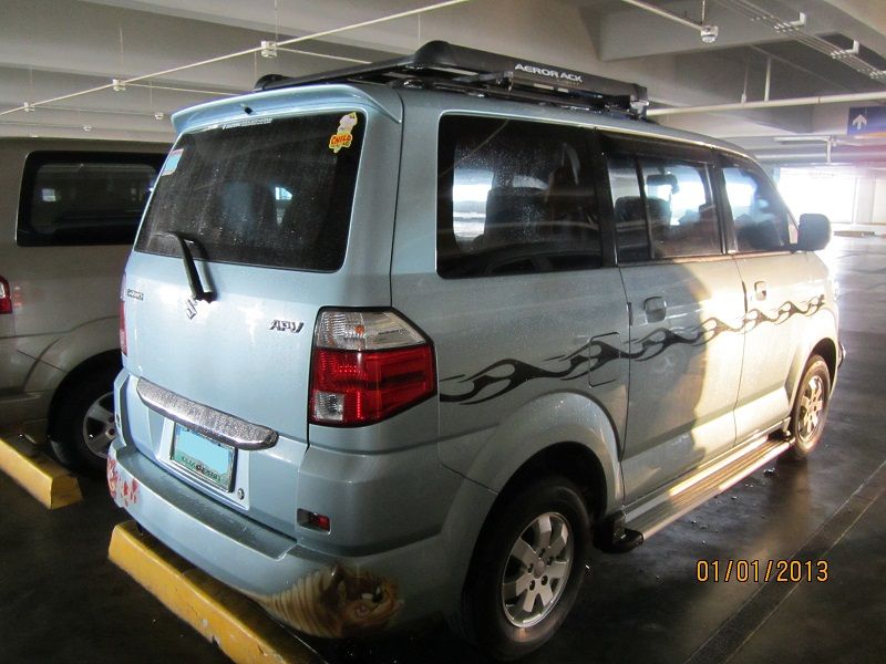

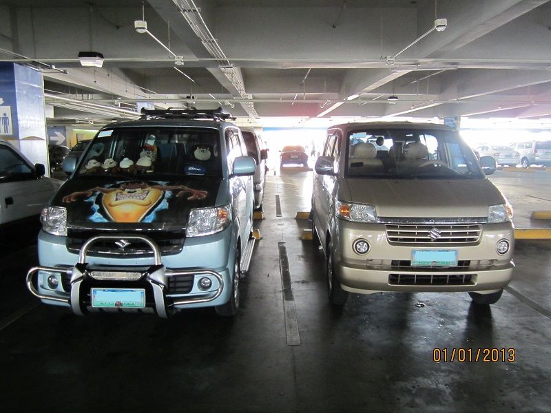

    Spotted a Suzuki apv with great paint works at MOA today !
    Very nice !
    Just sharing, thank you. (The beige color is my apv.)

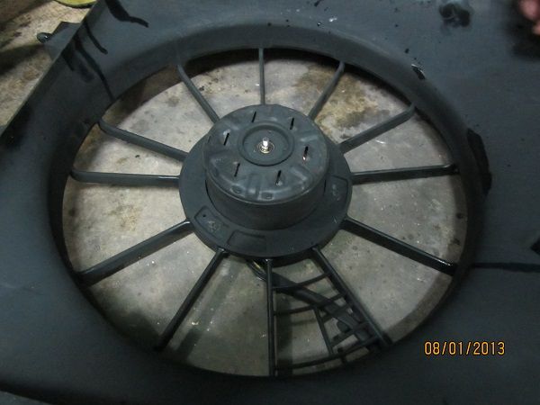

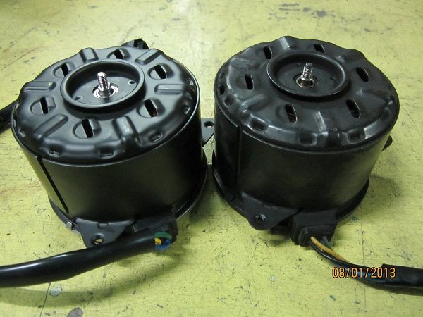

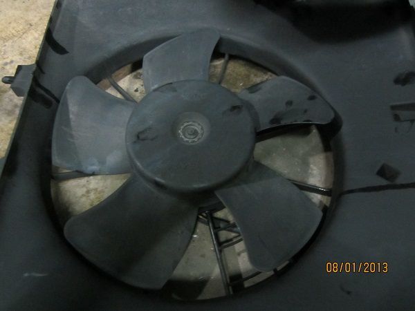

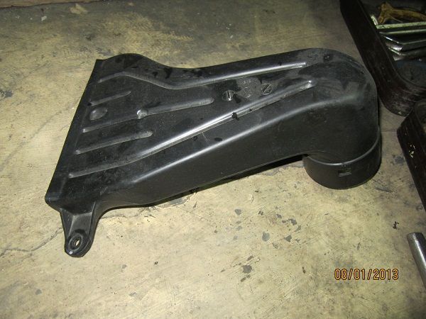

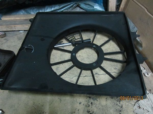

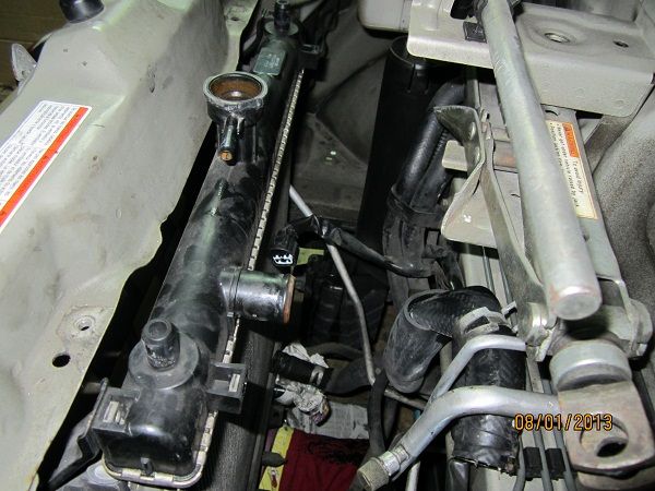

    When I parked my apv last Sunday at a Mall and prepares to turn
    off the engine, it was making this certain vibrating/ noise in front.
    I opened the hood of the car to inspect it and the fan's frame was
    vibrating thus making the noise and I thought one of the fan blades
    was broken. I turn off the A/C switch to stop the rotation of the fan
    and switched it back again. The fan rotates again but did not make
    this vibrating/ noise.
    Looks like I have to schedule a mechanic to check the radiator
    fan blade motor to see what is wrong.
    My mechanic came at 11:30 am today and pull out the radiator
    auxiliary fan motor. According to him it's disposable and I have to
    buy a new one because the bushing inside was damage already.
    They removed the air snorkel first.
    Drained the coolant out.
    Removed the auxiliary fan motor assembly.
    Removed the fan blades.
    Removed the fan motor.
    Have to buy the fan motor in Quezon City.
    Exact fan motor and four wire connectors.
    Please continue to see next post..........
    93
    #1468
    Did not find a four wires fan motor here in my area so I
    have to send somebody to buy it in Q. C..
    The price of Denso fan motor made in Korea was 6 to 6.5k Php.
    I decided to get the original and it was selling up to 9.5k at Motor one auto
    supply.
    Thank you, just sharing.

    Quote Originally Posted by keno4864 View Post
    supply.
    Correction to this statement, sorry.
    I decided to get the original at 8k Php at Icon Parts.
    Motor one Auto Supply was selling this at 9.5k Php.
    Olyimpia Auto Supply was selling this at 8.5k Php.
