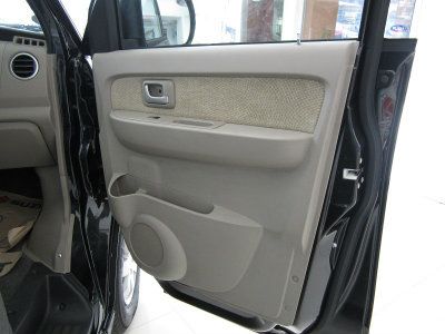

planning to replace my interior door panels for a better design.. and more comfortable of course.. since I have a GA model. its only a marine wood wrapped with vinyl...
around magkano kaya sa CASA ang interior door panels? or maybe pa-sadya sa mga gumagawa for interiors?
sana meron sa banawe or evangelista shops na surplus.. hehhee.... para kumpleto pati handles..etc..
