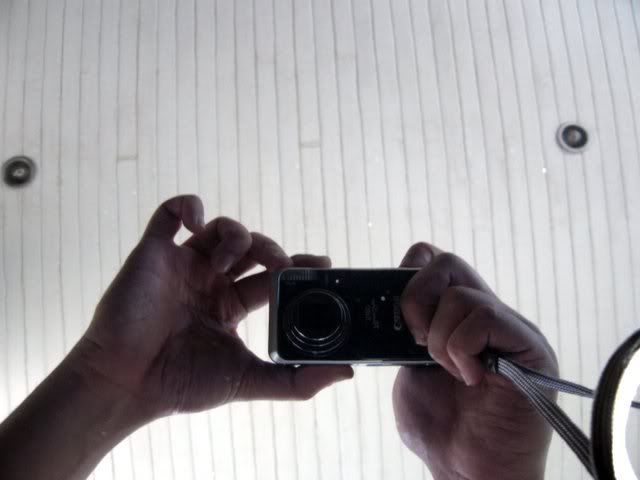

    luckily, near match naman yung paint na ginamit ko. hehehe
    I was a bit tired na after doing all of this but then I then decided to polish the trunk as well because of the scratches caused by my pet cat.
    here's a pic of the trunk after DACP:
    and the usual reflection shot:
    looks like I have to wait for some time to give the paint to outgas before sealing it. by then, I'll have to buff it again.
