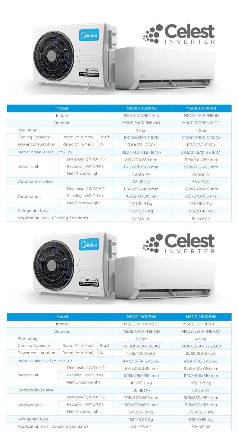

    Makikisabay lang ng tanong, okay ba ung Carrier Aura na 2.5HP and Carrier/Midea-based Split types in general?
    On paper it looks like a derated 3.0 HP unit (25,500 kJ/h rated; 33K Max which seems to be close enough to what Midea(MSCE-25CRNF8 -25,320 Kj/H rated; 26,900 kJ/h(25,500 BTU/h) max) and Daikin (D-Smart Queen FTKC71AVA- 24K BTU/h(25,320kJ/h) rated; 24.5K BTU/h(25,850 kJ/h) max) rates their 3 HP units at.
