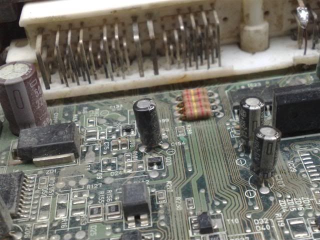

    Is there any hope for this ECU? I just want to know before bringing it to Speedlab or other ECU repair specialist. Sayang din P1,500.00 kung mukhang hopeless case na. It's for the Nissan Urvan Estate. Nasa ilalim kasi ng seat nakalagay and horizontally kaya talagang nababad.
    Putol ang terminal and hindi maabot ng soldering iron to bridge it properly

    i can see the IC being burnt... im no electrical expert pero parang kailangan palitan yung computer box na nasa pix.

    I can see a cold solder.. Pwede sa likod dukutin yung isang pin mahirap kasi tanggalin ang components sa double sided PCB. Naputol kaagad, inattempt bang paandarin, parang may overcurrent nangyari. Try monalang ayusin yung pin then palitan electrolytic capacitors..Kung ayaw, wash with soap and water, dry, then re-solder components. You have 50/50 chance sa nakikita ko. Kung mag ok man, hindi na tatagal dahilsa corrosion.
