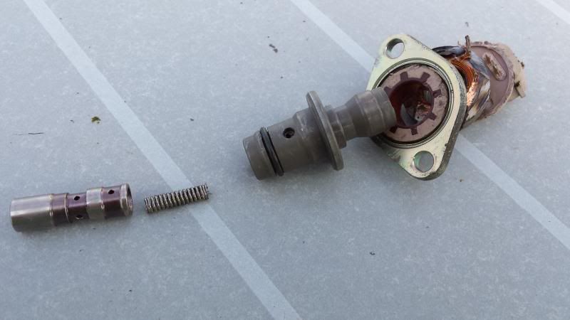

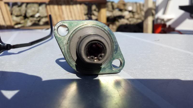

    Since may nakapag tanong na rin about SCV's, i'd post this for everybody's reference. I personally don't experience symptoms yet but in case needed I'm prepared to clean or replace it when that happens. For those who cleaned and replaced D40 SCVs, appreciate if you could share your experience. Thanks
    Thai 25mm unit PN#A6860-EC09A, there is also a 45 mm version.
    Grey and beige end cap are the old ones. The new better quality denso scv's are now dark blue/turquoise.
    Failure maybe due to dirty/clogged/stucked valve or the solenoid coil high resistance/open.
    It can be cleaned maybe by soaking to carb cleaner but the internals inc coil is sealed.
    Removal/ Replacement - Nissan-Navara.net ? View topic - Changed Suction Control Valve - (D40) (with pics)
    Stripping down - Nissan-Navara.net ? View topic - SCV stripped
    few pics for reference
