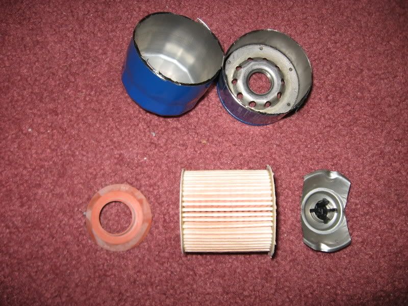

    Why OEM sucks. just take a look at one.
    Nissan OEM filter is of very low quality, paper end caps, terrible reverse flow valve, weak filter media, weak inner tube, and a pretty crappy by-pass valve.
    OEM
    Really bad media with cardboard end caps.
    Can easily collapse under pressure not to mention rupture and allow oil to go unfiltered.
    Most Japan filters are not much better

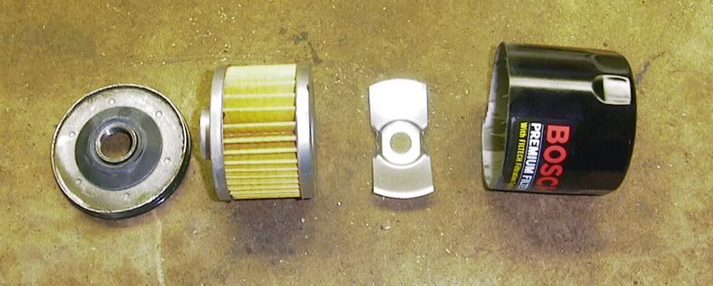

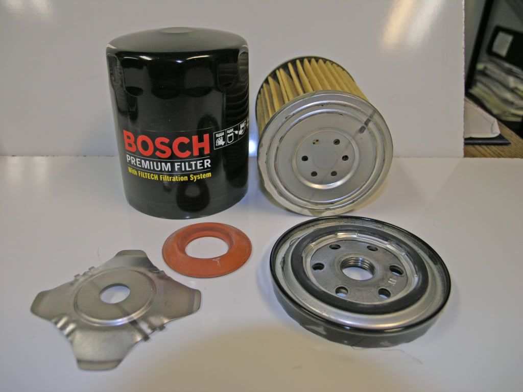

    * dvldoc: how about bosch filters? are they any good?
    Dec 2007
    1,961
    #167
    Quote Originally Posted by cydepx44 View Post
    They are a mid grade filter, made by the same company that use to makes Mobil1 which was Champion, now they are made by Puralator. They Regular paper filter media claim is semi synthetic, not so great bypass valve.
    This would be the one for your Navara D40 engine. Still better than the OEM Nissan filter by a mile. They are perfectly fine for 5000klm oil and filter changes.
