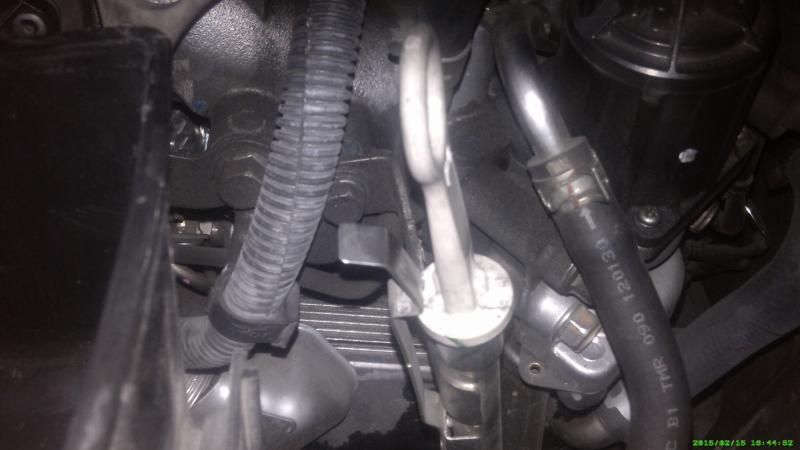

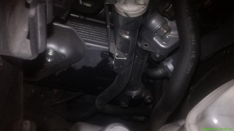

    need help mga bro. nakita ko lang kanina na may leak sa may lower part ng engine sa driver's side and i just want to have an idea kung saan nang-gagaling
    here's some pics:
    galing dito kaya nag-drip (from the black part) kasi sa taas niya iyong oil stain sa makina?
    nakita ko lang kanina ng pinupunasan ko iyong makina at kung anu-ano pa sa engine bay.
    btw pic was taken from behind the batt. thanks!
    bro, looks like its coming from the egr valve assy. binuksan ba sa casa yan recently? baka hindi nahigpitan mga bolts niyan bro

    Quote Originally Posted by zix888 View Post
    thanks for the tip bro!
