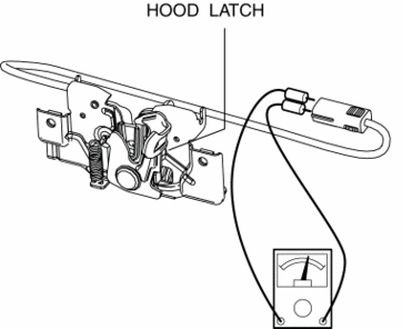

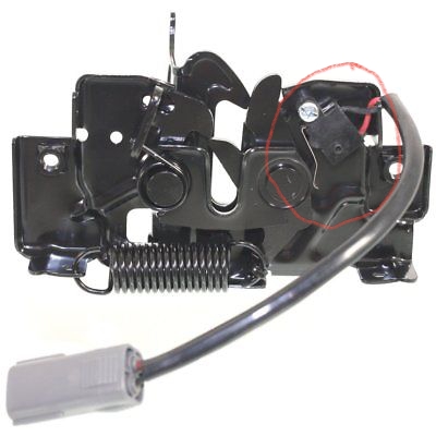

    You can permanently turn it off, sir. Just flip the bonnet latch switch to fool the system into thinking 'open'. The trick is reversible.[emoji4]
