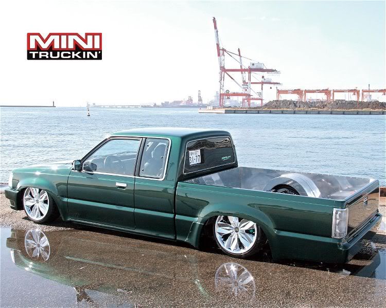

  5. #385
    some pics for inspiration...

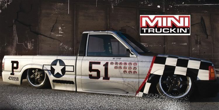

  6. #386
    sharing some more...

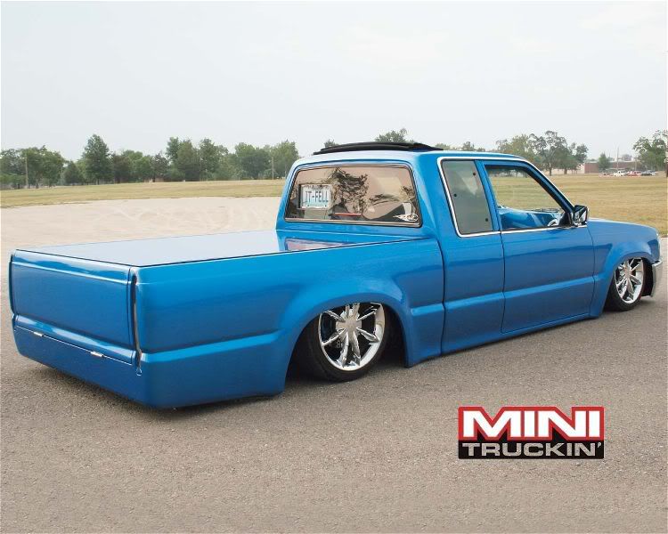

  7. #387
    notice the bubble top?
