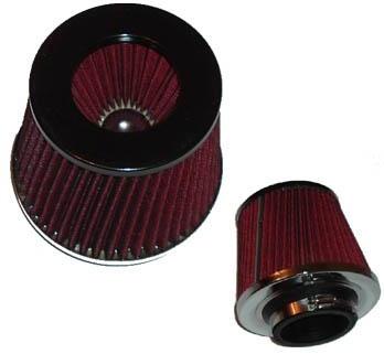

    CAI is fine but make sure the tube size and length is tuned for your engine. If in doubt, make it as simple as possible with minimum length and bends required.
    A car accessories shop in Banawe will give me a set of carb adapter, Simota cone and an odd plastic-like (?) flexible hose (similar to a washing maching hose) that can be stretched way down to the bumper.
    I'm not sure if it's that effective though.
    This mod is next in line. I'm kind of fickle-minded to proceed with the washing-machine hose type of cone filter intake kit I saw in Banawe last month.

    You can change it to the cone type filter (K&N or similar) which works better than the foam type element.
    Flex-type hose will rob you of engine power by making the intake airflow turbulent. It should be as smooth (internally) as possible.

    Would the tube-cone filter type make noticeable gains from the plate-type filter?
    Problem with this is engine bay space ...
    It looks like I can't fit a strut bar with the plate or cone filter on.
