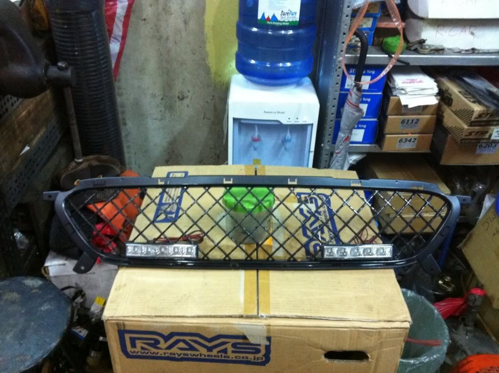

    hello to all accent owners! baka meron interested sa accent bumper sports grille w/ DRL (chrome/plastic) here's my contact number 09228391717 thank you!

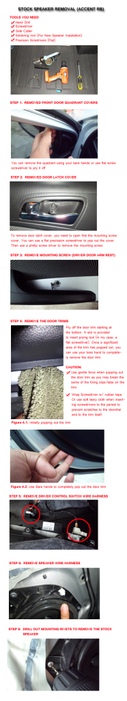

    Anyway, sa mga nagbabalak iDIY yong speaker replacement. Below is the D-I-Y instruction on how to remove your stock speakers. Use this at you own risk..
    Sa installation, it depends on what type of speakers you are installing. But basically you need aftermarket spacers to mount the speakers. Thickness on the spacers depends on the depth of the speaker itself. In my case, I have to use 1.5" of wood spacers, para hindi tatama ang magnet sa glass window when it's fully down.

    Sir, di na masyado readable yung text. do you have a bigger image of the above?
    Quote Originally Posted by meikey View Post
    ehehehe...

    oo nga. I don't know what happen. hehehehe, parang kinompressed ng todo ni photobucket yong file...
    Isa isahin ko na lang mamaya. nasa bahay yong file
