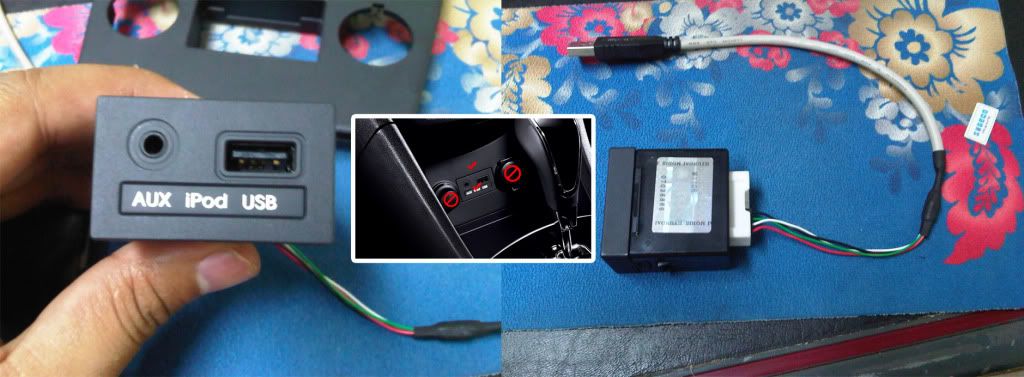

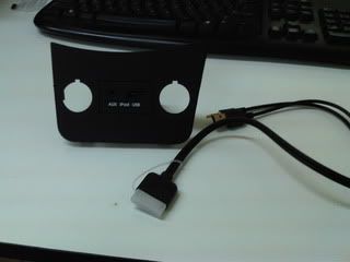

    Forget the problems & headaches for a while. Enjoy muna sa pagkukulikot ng tsikot..
    this feature should have been standard nowadays, but my unit (1.4AT) was deprived of having such a convenient feature. Though my new Headunit (Pioneer AVH-4250BT) do have USB/Auxiliary for ipod, but I couldn't stand looking at the compartment w/ a dangling USB/Auxiliary cables... So, went back w/ electronics 101, made and customized my own wiring harness and make it look like factory install.. ehehehehehehe
    OEM iPOD Auxiliary/USB Port...
    Had to make a custom harness to make it work with Pioneer AVH-4250BT Headunit

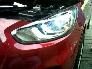

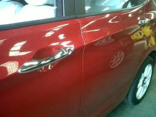

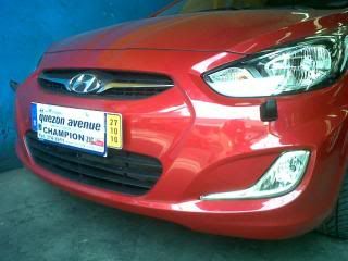

    my accent:
    installed:
    HID head and fog
    LED park lights (front and rear inc plate light)
    leather seats
    15" prodrive mags
    euro plates front and rear
    headlight washers
    chrome door handles
2011 Hyundai Accent Modification/ Accessories made
