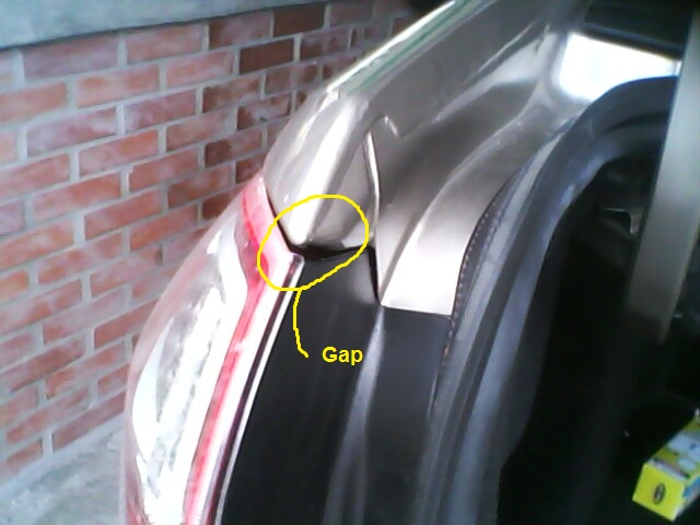

    Let's take a look at the tail lights:
    Balbon ang pagkakagawa nito. Aside from the large gap between the tail lights and the body. Very obvious yung putol ng body metal. Wala man lang masilya. Cut seems to be manually done and not via machine,
    Initially I was worried that the gap would allow water into the bulbs but water would not enter the bulb housing but just drain down further.

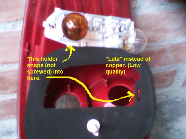

    Electrical pathways seem to be "yero" and not copper. Low quality again. The bulb holders are simple "clip on" or snap on instead of being screwed on.

    #53
    Nothing to "seal" the bulbs into the housing to prevent moisture from entering the housing. We have humid weather here and I do not yet have a "quick fix". This part requires more thought and more time to get a proper remedy. You will also see the small notch where the bulb holder snaps into.
    On the body side, the connector has good copper contacts. This tells me the supplier of the Fiesta's wiring is of a higher caliber than the tail light supplier.
    Plastic nut where a metal one could have just been as good. Metal shortage?
