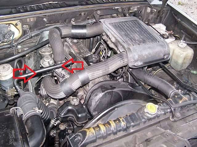

Hi Doc, got a Cusco OCC but have'nt put it in yet. Need to still have the appropriate fittings/hoses/clamps to do so. But just noticed that there seems to be nothing inside it, though just managed to peek on the holes only. Browse the web out of curiosity and seems that most of the known branded OCCs have nothing inside or un-baffled, as they term it. Is this effective, some say yes others say no? Contemplating on having it opened and put some perforated sheet between the two nipples? TIA.
