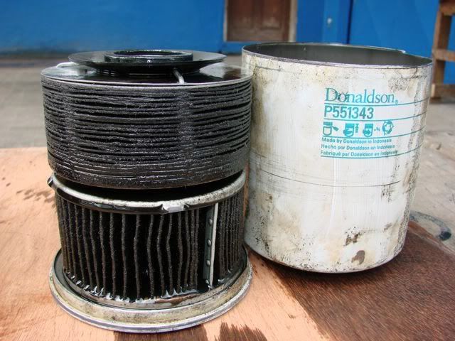

    Finally I was able to do a test regarding the So called "fake fleetguard"
    sorry Dvldoc but I was just too curious that's why I wasn't able to follow your tips so I used the filter that I was able to source out from the said official distributor of fleet guard(the one in the pics Ive sent to you) regardless of what you said on making it a paper weight....haha!
    so with that I have to see it for myself and volunteer my truck to be the guinea pig....its just a good thing that it didn't broke down...hehehe
    So here it is...
    I've used the oil filter that was given to me for free by a sales engineer of this company that sells fleetguard 10,000kms ago
    here's the pic of the element.
    as expected it has a dual filtration media if I can call it that way.
    here's a closer look
    Im not sure if how would I judge the filters media....
    So please do tell me if I just got lucky that my truck didn't broke down...haha!

    here's the pic of the inside
    another angle

    All I can say is holly god, look how bad that fake filter is made, Look at the over running glue everywhere. The second half of the filter has some super cheap media that looks like thick cardboard and shows it hardly caught anything compared to the closer spaced media. Also see how the glue is oozing out, that can easily make it's way into your engine. Or worse yet the media blow completly out and not be filtering at all. Either way Pacer should pay attention to this filter as it's clearly not a real Fleetguard and could cause damage to someone's engine. (I'm sure they still follow the thread)
    A real Fleetguard would have also been stack disk not just a second filter element like OEM, it should look like the Donaldson equivalent.
    Good thing you got that off the vehicle it looks like the glue was breaking down and starting to run out of the filter. This is a prime reason you never run a knock off, you never know what the quality is and the quality of that one is piss poor. Your better off with a VIC than a China clone of any filter.
    As far as the fuel filter goes, JS filter shows a different cross reference for the 4m41 but then again they could have a error in there database. Kinda hard to cross it stateside because that engine does not exist here.
    But when I search the OEM fuel filter number is ME132525 which equals BF7842. maybe it's only for a certain production year. But if that fits then use it. I am not always right but I do my best to research part numbers as hard as possible. But looks like the older 4m41's use the same filter as the 4d56 and 4m40.

    Here are a few other issues with that LF3830 it's not supposed to b a combo/bypass filter it's a full flow which means a single element. The cross for a BD28 for Fleetguard is LF3564 which is a combo filter. So not only did the China fake make a piss poor filter they got the filter element wrong as well.

    Weeeew! I think I got it out just in the nick of time
    i was also wondering what are those bronzy things pooping out of the media....Little I had know that its the glue that bonds it....
    thanks for all the info doc, well appreciated!
