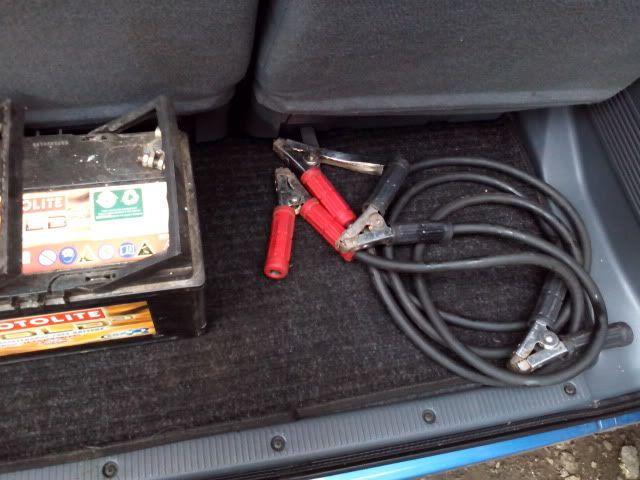

    Sirs, ask ko lang. Critical ba yung amp rating ng mga battery booster cables? Sa 2.0Li na engine ano dapat rating?

    In my experience, YES. Lower AMP rated cables simply cannot carry enough current to crank-over the stalled car and just end up getting hot and may even melt through their insulation. But it does not really matter if the car is a 1.3 or 2.0L ....

    Most commercial jumper cables are 4 American wire gauge size do automotive use and will suffice for a 1.3 liter gas engine

    So what's the ideal AMP rating to buy at the least?
    29,354
    Maybe 400 or 500 amp cables....
    Also aside from the wires, check the quality of the clamps.
