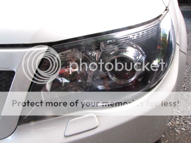

July 2nd, 2014 05:18 PM #21972010 Subaru Forester FXT:
Another RETROFIT REDUX! Car came in with poor lighting output, burnt hl lens and spaghetti wiring. Even one reflector bowl was damaged by the previous retrofitter with a 3" crack on the sides (the projector was forced during alignment). What's worst is that the OEM ballasts were removed including the ignitors and replaced with cheap ballasts! We restored the lens, installed our OEM package including the OEM Matsushita ballasts and completely brought back the wiring to OEM specs. We also installed our 70mm fog projector retrofit as the previous shop installed bolt on bulbs on the stock fog housing.
- Join Date
- Dec 2002
- Posts
- 2,335
July 2nd, 2014 05:22 PM #2198Above Subaru with the old retrofit:
burnt HL lens
ballast mounting
HL sealed with silicon
missing oem ignitors replaced with cheap ballast
old miniH1 projector
cracked reflector bowl
