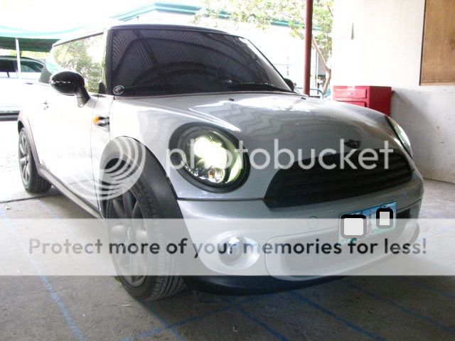

    Very excited to this as this is one of my dream cars. Many concerns with bulb out warnings and flickering ballasts. Ended up doing my own cancellers which are way better than the ones off the shelf. Made the custom printed boards with Japan made parts and viola! zero error codes. 3.0" bixenon projectors, Philips 85122+, 70mm fog projectors! Love this project! We also did a one-off LED park lights to replace the stock halogen bulbs which I think is really cool! This setup will outperform any oem lighting system by mini. Owner is a very cool dude.. or gal should I say! Thanks!
    fogs
    fogs with LO
    fogs with HI
