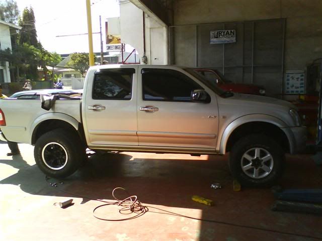

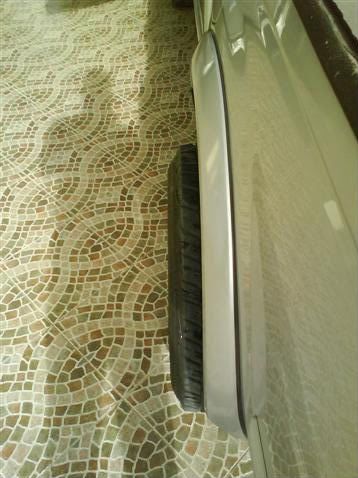

Here's what I did with mine. 265/70/16. Rims are 10 inchers (I think) sorry, I also forgot the off-set:
wide huh?

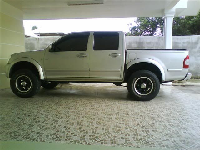

how it props up the truck.

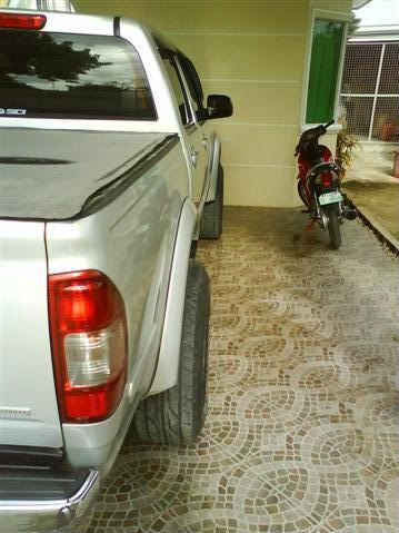

clear comparison between them and the stock rims. Big sucker ey?

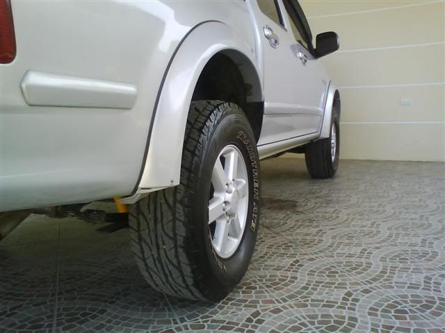

Now with the same tires on stock rims:
Nope, no lifting kit here. I simply turned-up the front torsions then replaced the rear shackles with longer ones. I think it gave it at least a 1 1/2 inch lift. Remember this ARB? Hehehe.

just one question lang po.....can you clarify the size of the mags? if it has a 9 or 10 inch width? because AFAIK the limit of 265's or 32" tires is only 9 inch width base from the wheel catalogue that I saw.....however if its a 10 incher, I believe it has some safety issues to compel with...

I sold the set already last year so my poor memory is the only reference.
You're right sir, I think this was a 9" width. My basis for describing it as a 10 is because I remember that the tire shop had a very hard time mounting the tires since there was such a large gap brought about by the wide rims.
Yes, if this were a 10 it would have been catastrophic over large bumps hehe.
