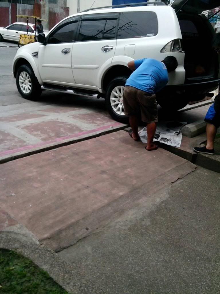

    No idea what year model. Saw it at Jemson's shop getting LED bumper lamps installed. With MSCP stickers.
    Sir painted ba yung mags niya? O mejo malabo lang mata ko.hehe balak ko kasi pa repaint yung stock mags ng white pero hindi ko siya ma picture in my mind kung baduy ba or sakto lang hehe salamat
