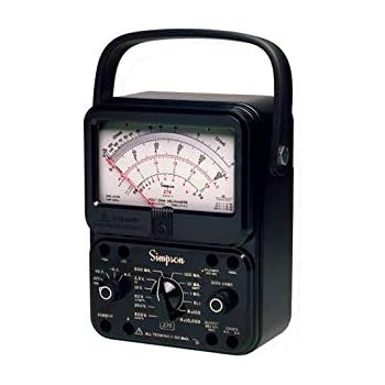

    About the American brand, you're probably referring to Simpson. These are the ones we were using in our electrical labs before.
