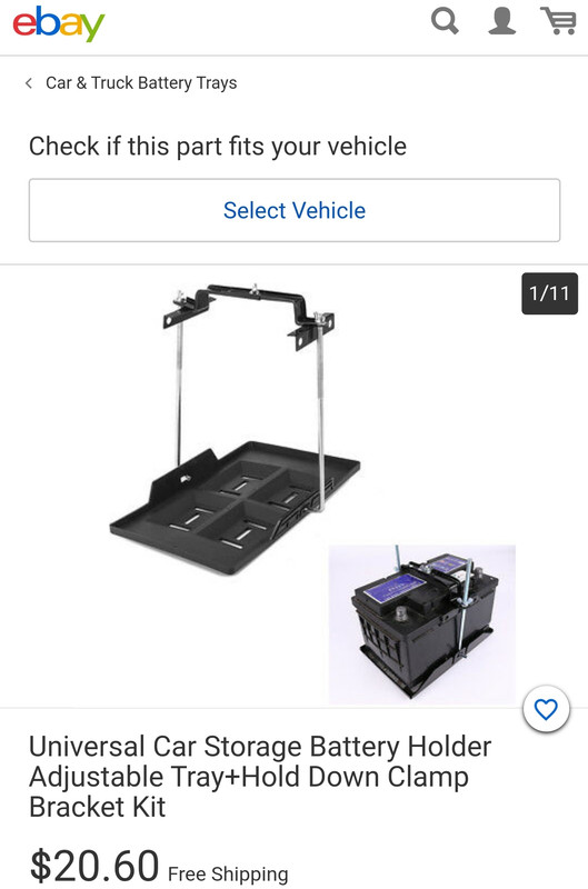

    I have the same kia/hyundai feature but at least the batteries here aren't that expensive.
    heres what you need to get those lesser priced priced batteries.
    6,495
    Thats what I had in mind. He will just have to modify it by shortening the brackets.

    Thanks for the suggestion.

    I think that's a Kia-thing, the lockdown is at the bottom. My Sorento also has that. Didn't know Enduro doesn't have the cut-out tab at the bottom. I use Gold too, they last +3 months after the stated warranty, w/c I think is the same as yours.
    I think you can use the Enduro, but you will need to modify you mounting bracket into the generic battery tie down (cross-bar with 2 hooks). It should be a cheap fix.

    With the current battery tray of the Picanto? Yes. This is the one I currently have: KIA PICANTO 1. BATTERY TRAY 3715-75 | eBay
    So there are no holes for the hooks featured in the example by _Qwerty_ that does not include a tray. This one: Car Storage Battery Holder Adjustable Stabilizer Metal Rack Mount Bracket Kit | Lazada PH
    The one with a tray included should work: [Constan][COD][Freeshipping for Any 3 items]Adjustable Car Storage Battery Tray Holder Base Hold Down Clamp Iron bracket Kit | Lazada PH

    as i recall, a locally manufactured set of hold-down clamps cost me less than 300 bucks from a shop in either pedro gil or pasay rotonda...
    just looking at the pictures...
    post-er might remove the car's tab clamp and bolt, and insert the foot of the L-clamp into the bolt's hole.
    14,700
    150 lang bro yan sa concorde, pero yun walang tray

    Thanks for the input. I'm from Cebu but don't know who sells that brand here locally. I'll look into it.
    Maybe. But it might require some MacGyvering to fit. Thanks will refer back to his post when the time comes to replace the motolite. :D
