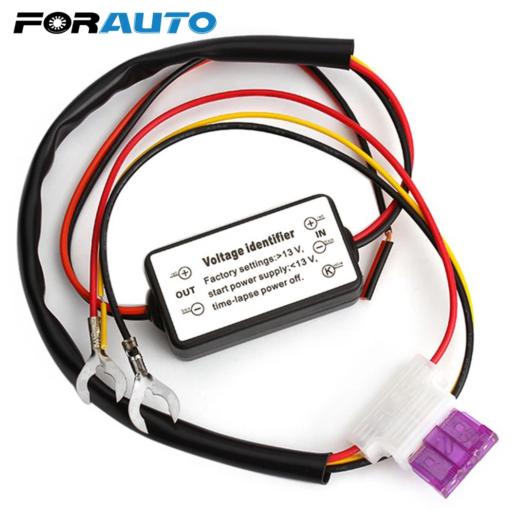

    Buy ka na lang ng ganito flush mount Drl sa Amazon. [emoji846]. images-20-202020-07-24t194304.299.jpg

    a good auto electrician should be able to tap direct from the battery and have its own fuse to boot.
    also, look into your fusebox. there might be a spare tap there for "accessories".

    No special fuse.. pero pwede ka mag gawa ng wiring to trigger the park lights using relays and diodes or install a dedicated drl tapped to your accessories line..

    Use a voltage sensor to turn the foglamps on only when the engine is running. Another relay will be wired in parallel to the existing fogLamp relay contacts.
