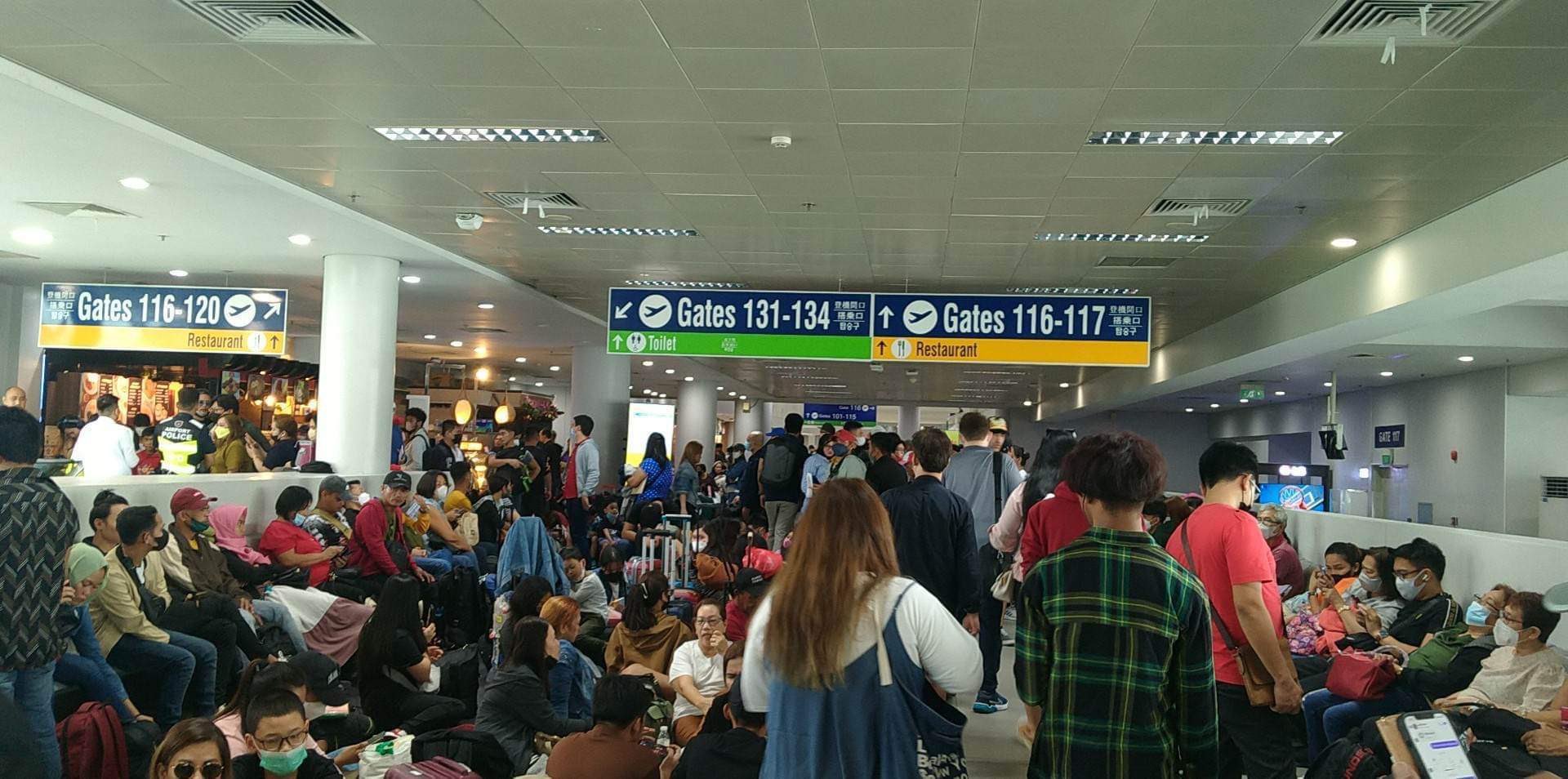

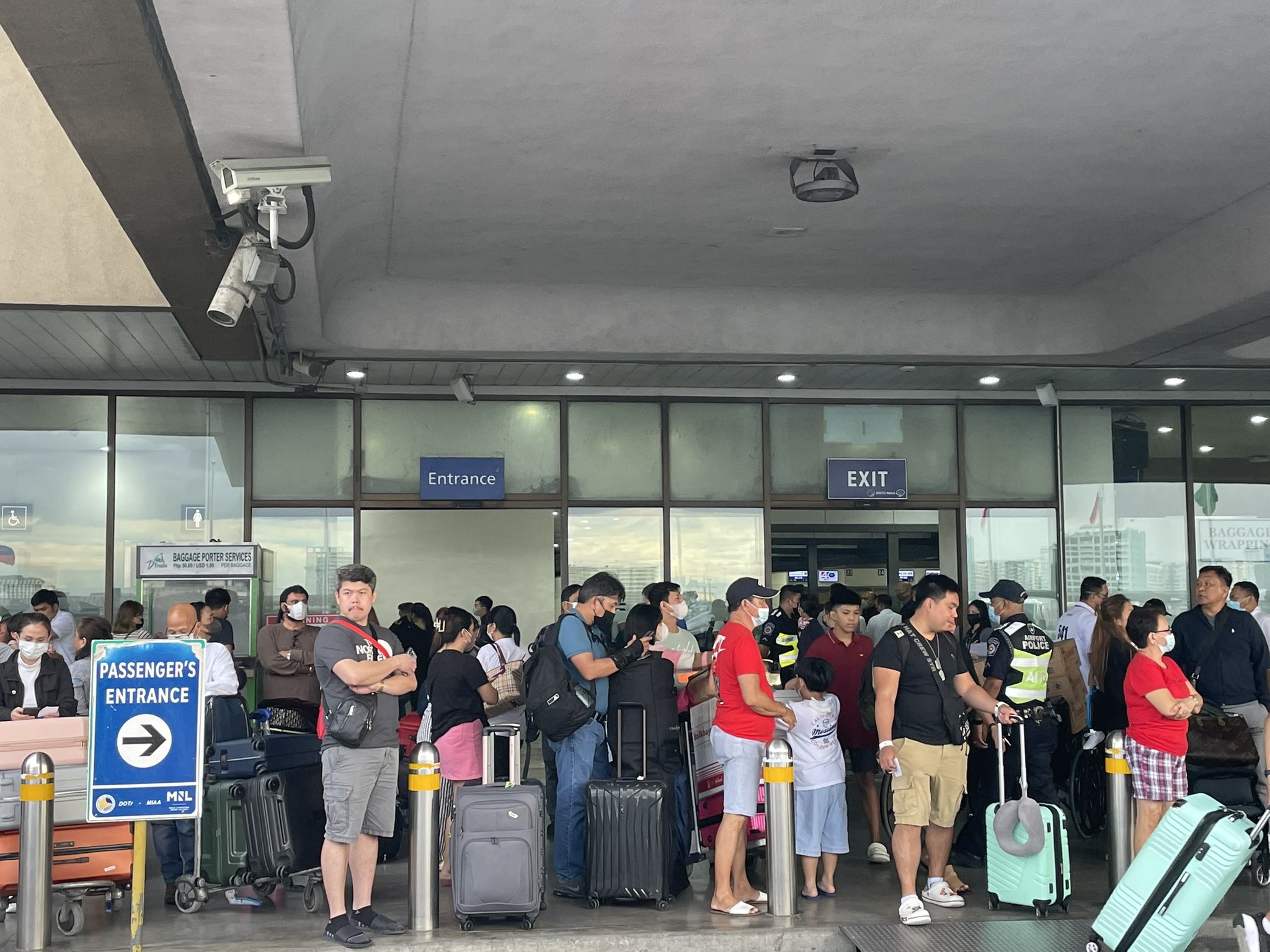

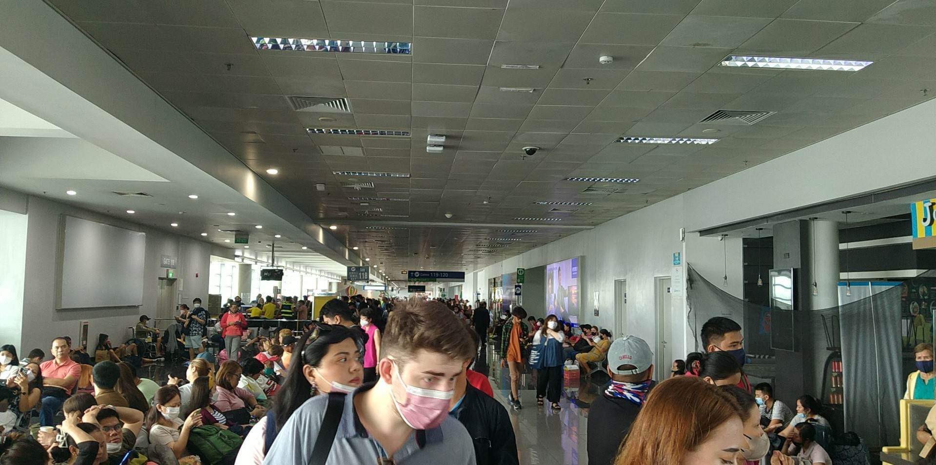

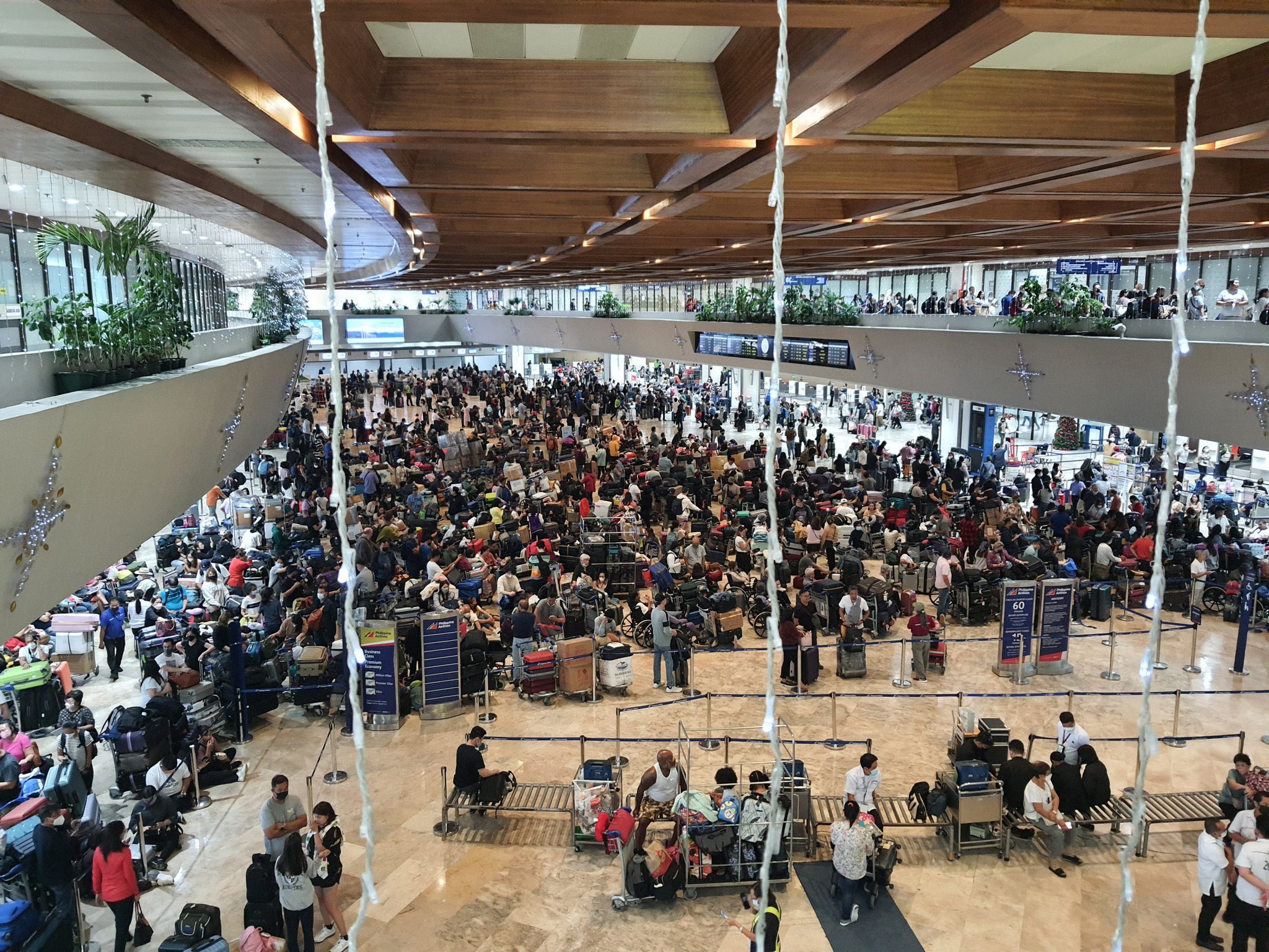

    Flights have somewhat resumed pero at the rate of one arrival every 10 minutes... considering almost 300 flight backlogged.
    Earlier at NAIA
