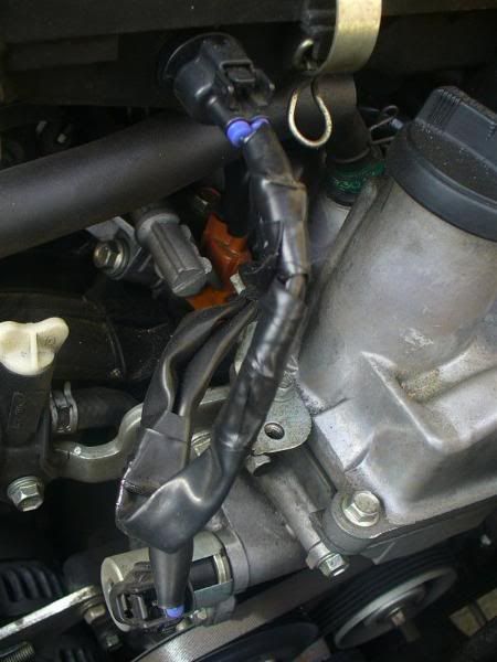

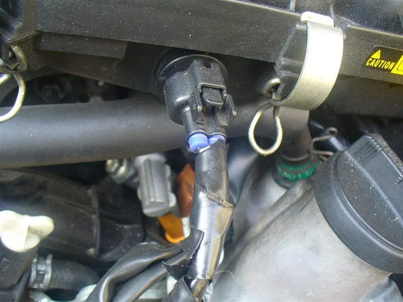

    Quote Originally Posted by armin75 View Post
    The "Engine" symbol (like a pipe) on my Avanza started lighting up a few months ago. Habang nag drive, iilaw siya then mawawala naman agad. Sa manual ang sabi bring to Toyota Service immediately.
    The things I already did are disconnect the battery (to restart the EFI), change my air filter and switch to premium gas. I'm still observing it. Once ko pa lang nakita ulit umilaw.
    Have any of you guys experienced this problem? Nasa 35k na pala ang Avanza G 1.5 Manual ko. Thanks!!!
    That is the check engine light. There were 3 of us that experience that. The culprit is the MAF (mass air sensor or something).
    Dahil pag PMS tinatanggal ito sa air filter box para mapalitan ang sparkplug, di maiwasan na mai-bend at eventually maputol ang wire. Puwede naman ma repair ng casa, charge to warranty. sa Toyota Shaw namin pinagawa. Di na ulit bumalik ang problem. hinag-hinag lang.
    mayroong diagnostic computer na ikinabit sa avanza sa ilalim ng steering wheel. Lumabas ang error code at nalaman na may problem ang MAF.
