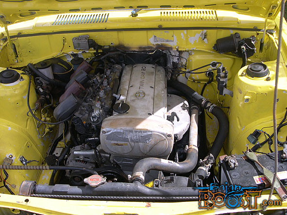

    Here's a TE72 Corolla Liftback with a 16-valve Twin-Cam 4A-GE from an AE86.
    The 16-valve Twin-Cam 4A-GE engine was first used in the RWD AE86 which had a similar platform to the older TE72 Corolla Liftback.
    Of course the 4A-GE engine should come along with a 5-speed gearbox too, I think the Corolla Liftbacks here only had 4-speed transmissions.
