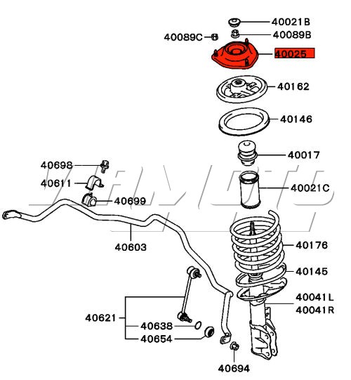

    Sounds like the strut/shock absorber mount is busted. The TOK sound is the sound of your coil twisting due to a bad mount. Open your hood and look for these (left and right):
    Check if there is a crack, breakage, tear or looseness. If yes, it's time to replace it. Check your coil as well if it's moving when you turn your steering wheel. Have someone steer the wheel for you while you check.
    If you're interested in the assembly diagram, here it is: (The red highlight is the strut/shock mount).
    I hope this is your problem.
    Disclaimer: I'm not a mechanic. It's just through headache and experience. Lol!
