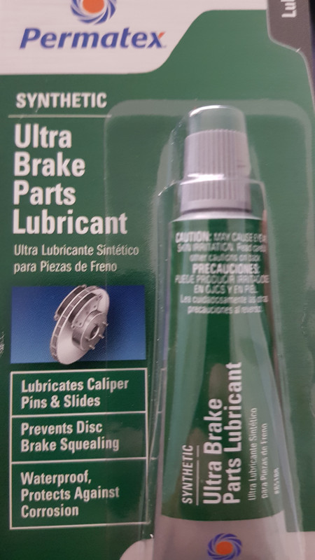

    14,700
    Use this....
    Magkano yan, and san nabili bro?
    Sent from my SM-C900F using Tapatalk
    Dec 2017
    2,686
    You can check post number 19, a similar product good for metal and rubber. Don't worry as the same guy, *travajante, recommended it.
    12,396
    Amazon has this under $5 or the bottle around $12.

    12,396
    Lazada has it.
    Permatex 85188 Ultra Disc Brake Caliper Lube, .5 oz. | Lazada PH[SSC-000000000000-00000-00000-0]:%20Smart%20Shopping%20Campaign&utm_term=[SSC-000000000000-00000-00000-0]:%20Smart%20Shopping%20Campaign_xxpo0000000at0000_ m_pla-296303633664&adjust_tracker=t2v78t_5n20iw&adjust_c ampaign=1032129542&adjust_adgroup=52512091404_m_pl a-296303633664&adjust_creative=296303633664_28100849 6_124310096&tracker_limit=1000000&ef_id=WRMw6gAAAE xGa0BX:20180924101414:s
    6,107
    Lazada has it.
    Sir travajante, will .05 oz. Be enough for all 4 brake calipers? Or should I get the 2 oz. One?
