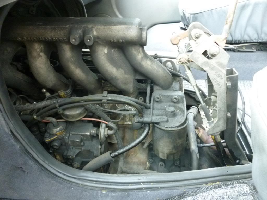

    magandang hapon mga kaMB newbee po ako.. tanong ko lang po saan po makikita ang primary fuel filter? ano po pagkakaiba ng head gasket cover at c.head gasket mga sirs..... thanx po sa iyong lahat..
    help naman po..ano po kaya sira ng aircon switch selector sa blower sa harap pag-on po ng a.c. then select ko number 1 nagbabago po idle or andar ng makina pero wla pong lumalabas na hangin pagdating na po sa #2 - 3 - 4 ok naman po at mas malakas po ang lamig ng a.c. sa harap kesa sa likod..thanx po uli..
    22,658
    #3277

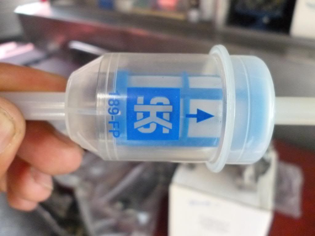

    The primary fuel filter is along the fuel line. I think somewhere near the driver's side when you remove the dog house engine cover inside the vehicle:
    The valve cover gasket is just the superficial gasket that runs around the top of the valve cover. Here it is, newly replaced (with white seal) on my unit:
    The cylinder head gasket is located deeper and is sandwiched between the block and cylinder head. Head gasket failure requires an engine overhaul:

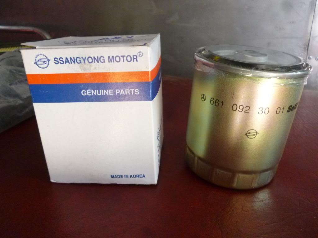

    And here is the main fuel filter. It's the round thing that's sized like a coffee mug.
