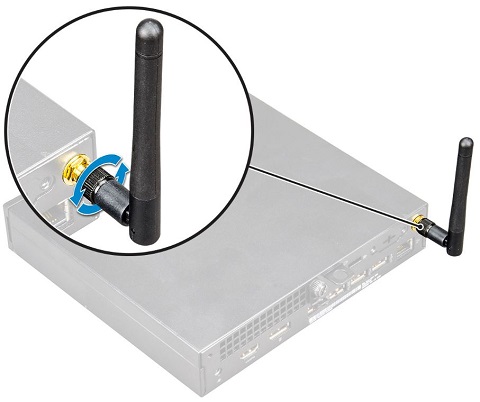

    Images are of a 3070, 7000 & 7090 but the 3000 & 7000 series MFF PC layout is just about the same.
    Differences may vary even within the same series. Some has the 2.5" SSD/HDD expansion slot while others are M.2.
    The 3000 has a single universal 3.5" audio out, while others have individual line out and headphone out ports.
    The number of DisplayPort, HDMI port, USB2.0/ USB3.0/ USB-C port varies also as BT and Wi-Fi availability.
