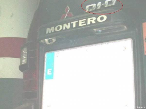

    Sir do you know where could i buy a DI-D emblem just like what is shown on the picture.. Im planning kasi to put an emblem but i cant find a DI-D what i have is a DDI emblem which i plan to put on the side fender of the new montero just like what fortuners have D4D emblems on the side fender, is it just the same with the DI-D..i called mitsu dealers but they dont have Di-D emblems available

    I think you can get one of those at Beyond horizon it's in C3 road before Maria Clara.
