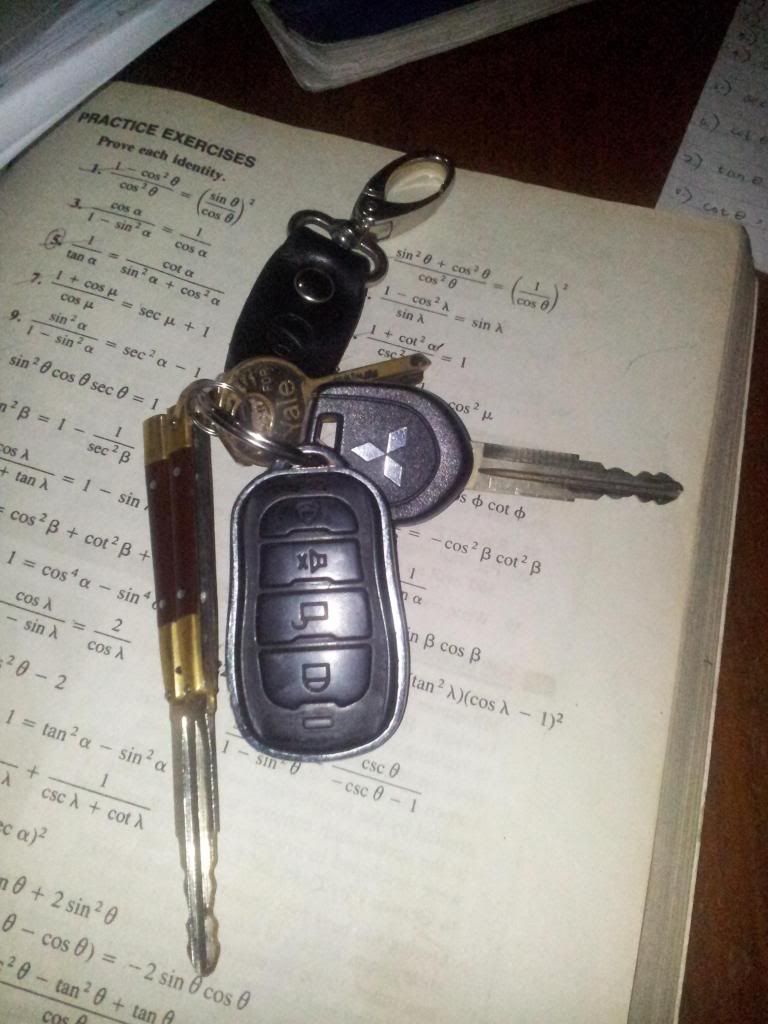

    awaiting feedback here also about the alarm. the manual for the alarm which came with the unit refers to a valet switch and a valet mode? but our keys have only the lock and unlock buttons and the car manual does not mention a valet mode. i wonder if the manual is for the alarm installed? it says " PA130P2-V4 MANUAL FOR KEYLESS ENTRY UPGRADE SYSTEM". do you have the same?
    thanks a lot
    Alam mo sir kung anong brand nung car alarm?
