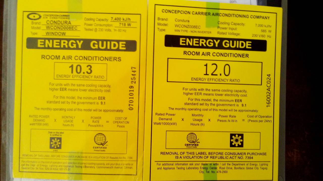

    OT mga sirs, but the Condura 0.75hp non inverter window ac I just bought has difficulty cooling our 10.5sqm room within 2 hours at night with the thermostat set at 75%. I am comparing this to our Carrier 0.6hp non inverter window ac, which it replaced, which can cool our room within 2 hours at even 50% thermostat level.
    The thing is, the authorized tech said that the ac is cooling normally since it can achieve 18C in 15 minutes at full thermostat setting. What could be my problem?

    do you still have the yellow energy efficiency level paper, po?

    Yes Doc, for the Condura, it says 12.0 EER with cooling cap of 7,000 kJ/hr and 585 watts power input. I probably already threw away the one for the Carrier.
    But I saw, one of my old Condura same model and it says 10.3 EER with cooling cap of 7,400 kJ/hr and 718 watts input.
    Are they bringing down the specs purposely or is it because of the change in refrigerant? I'm guessing, my old unit uses R22.
    https://s22.postimg.cc/ejahmdgnl/EER.jpg
