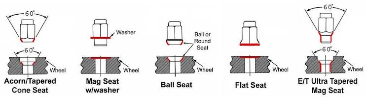

    What kind of lugnuts do you use? Tappered, acorn, etc? Kahit di na as long as torqued properly ang nuts and using correct type of lugnut for your aftermarket rims.

    Sorry, cant tell but the rims will dictate what type of lugnuts to use.
    FYR: https://encrypted-tbn1.gstatic.com/i...hLpAzjMgPjpQnQ
    Hopefully, it's not yet too late since if you use acorn style nuts on a tapered seat rim, it wont auto-center properly and youll risk damaging your rims' lugnut seat. If that happened, time to buy a hub centric rings na nga..
