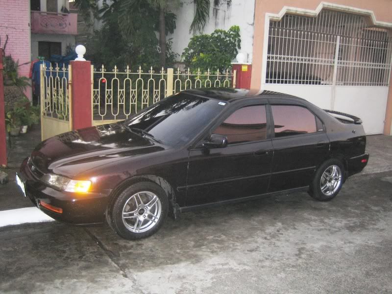

    My daughter actually wants to change the stock wheels of her Honda Accord 1994. She wants a Rota Cobra 3 17 inch. I had been trying to explain to her that it is better to get a 16 inch than a 17 inch as it has lots of disadvantages and 1 advantage which is the "pogi points".
    This afternoon, we went to Evangelista St., at Wheelhaus Marketing. We met this gentleman named Jojo. As the Rota Cobra 3 is not available, we opted for the Rota Quake 16 inch, than the 17 inch Conquest.

    Kung pang porma lang naman..either 16 or 17 will be ok..Both should be given a lot of TLC for them to last..given the road conditions sa pinas.
    For me..if this is my only car..I would not do this...because it will make my mobility limited...I should always be careful where I drive...which I don't care most of the time. For me..Safety and Performance comes first before aesthetics.
    My question lang po is..why buy 5 pcs? Just get 4pcs and use the old spare.
