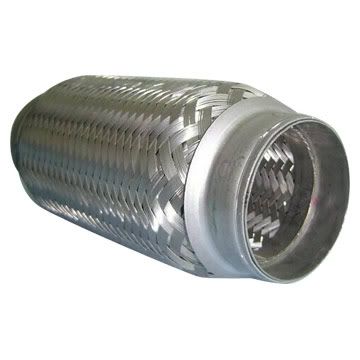

    kailangan pa ba lagyan ng flexible pipe ang smoke pipe? ano ang advantage at disadvantage?

    hindi, para siyang strainer.hehe may pic na ako pero hindi ako marunong maglagay na pic dito...

    Email me the pic. I will upload for you.
    Send to: benzmizer*gmail.com

    does your smoke pipe means muffler?
    if yes, its a good idea to put a longer flexible pipe to lessen vibration.

    aw ok2x... yan din ang sabi ng mechanic.
    ano ang lifespan ng flexible pipe? city drive lang naman..

    Here it is:
    ramledi is correct and as I thought earlier (muffler-related) this would absorb the vibration from the engine --- also prolonging the "breakage" in-between pipes.

    ano ba ang lifespan sa flexible pipe? 1 year plus?

    Wait, why are you contemplating on installing a flexible pipe? Wala ba iyo? What model is your Crosswind?`

    meron naman. 2001, maliit lng ang original na flexible pipe sa xwind, advice nila sakin lagyan ko daw ng flexible pipe... pero o observahan ko muna ung pipe ko, kasi bago lng ako nagpa repair...

    Ah ok.. From my knowledge, the flexipipe lasts long... long enough that you need not have to worry when to replace it.

    Yung 03 XUVI ko pinalitan ko noon kasi lagi nasisira, at nilagyan ko ng mas mahaba, similar sa pinost ni benz, after 6 years and 140k km its still there alive and kicking
