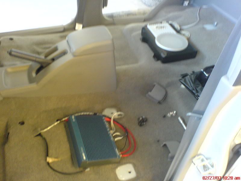

Mga peeps, share ko lang what I did with my sounds. Pasensya na medyo malabo ang pics...

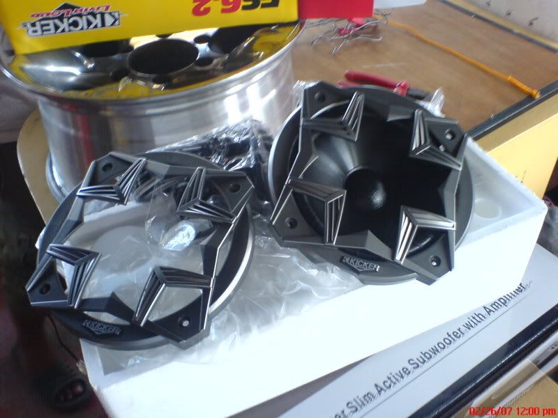

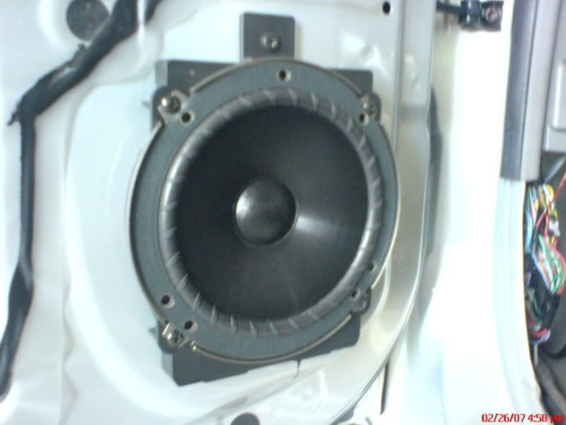

I replaced my separates with 6" Kickers na Es.
Direct replace lang to the stock mounts, no cutting..
then we stripped down the seats to neatly accomodate the 180watt superslim subs at the rear. Built-in na ang amps into the box that holds an 8 incher. The blue Soundstream amps is from my other car; it drives the Kicker seps.

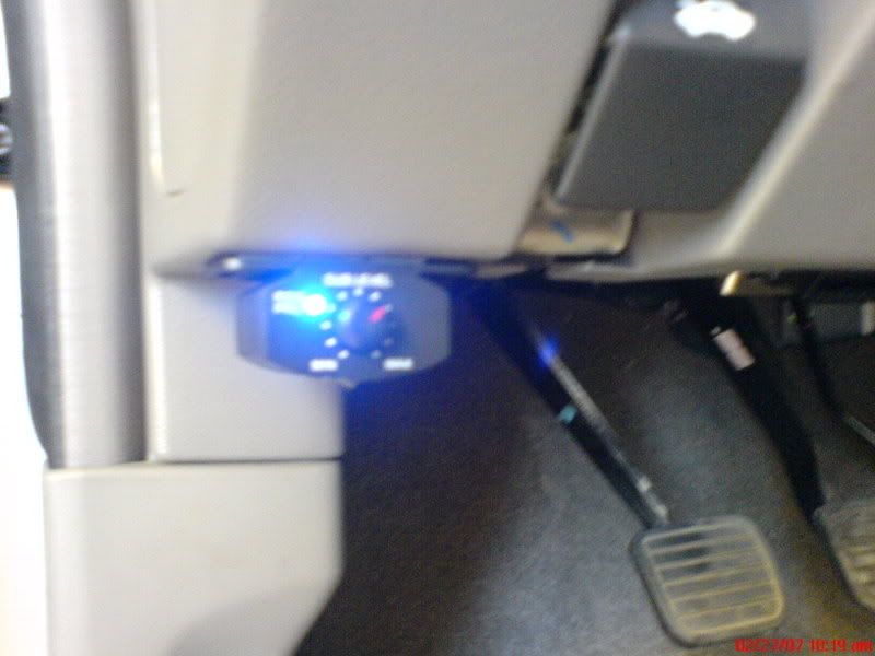

the remote for the subs...
The subs fit snugly under the rear seats since its really built for pick-ups. The bass quality? Very good! At least for a pick-up interior that is. It's the best I've heard so far from ultra slim subs. It sounds like a 10 incher even if I open the doors for tambay listening.
Oo nga pala, di ba the earlier Dmax models ('04,'05) sported Blaupunkt separates? Well I was in for a surprise when I found out na mine (an '06) wasn't. In fact, hindi nga manlang Dai-ichi, talagang walang tatak as in local. Oh well, the '06 releases were assembled locally nalang so I guess that's what we get.

Wow! Sure looks snug--the powered subs and the seps. Can't help it but post today..my first. 'Been reading this thread for the past month or so and this really got me going
. I have been dreaming of upgrading my sound system pero wala akong kaalam alam how. Mine is a '05 Dmax 4x2 manual na silver. Walang binago--just the stepboard, bedliner and the hood visor.
Memphis Raines, anong brand nang powered subs mo and how much did it cost you?
