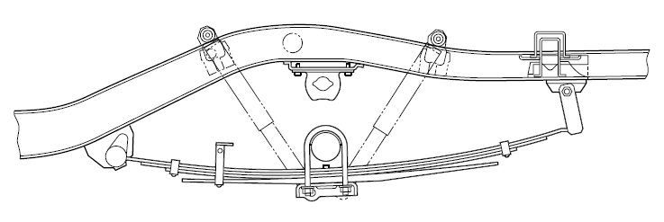

    hello.. ask ko lang ilan ba talaga leafspring ng 2001 XTO?
    i bought mine 2nd hand napansin ko kasi four pieces ang leafspring, na compare ko ito sa 2009 model na 5 pcs ang leafspring.
    binawasan kaya yun ng dating owner para d matagtag?
    thanks
    Ayon sa mahiwagang crystal ball ko, XTO used 4 leaf springs. (refer to diagram below)
    .... so stop worrying and enjoy your "new" purchase. Congratulations!!!

    wow nice picture benzmizer thanks..
    yung nakita kong 2009 i think its XT. taka ako bakit 5pcs leafspring.

    Quote Originally Posted by anthon05 View Post
    You're welcome.
    For our common reference, the Crosswind introduced the Flex Ride Suspension back in 2005.... and it's the same suspension that is still being used as of today. So it is likely that that 2009 XT you saw is already using the Flex Ride Suspension.
    It does not automatically follow that if you see a set of (5) vs. a set of (4) leaf springs it means the former is "bumpier" than the latter. Leafs are made of the same structure but can vary depending on thickness --- which would have an effect on its ride and performance.

    yes I think your right the one I saw is a newer version probably what they
    call flex ride.

    ask ko lang sir benzmizer kung pwede kabitan ng flex ride suspension yung 2003 xuvi matic namin, kasi napansin ko, kahit bagong palit yung shocks (all original) mas matagtag pa din sya compared sa sportivo 2009 nung friend ko,,
    Pwede. Palit lang leafs yan. The spring constant of the 2004-older is higher to that of the Flex Ride.
