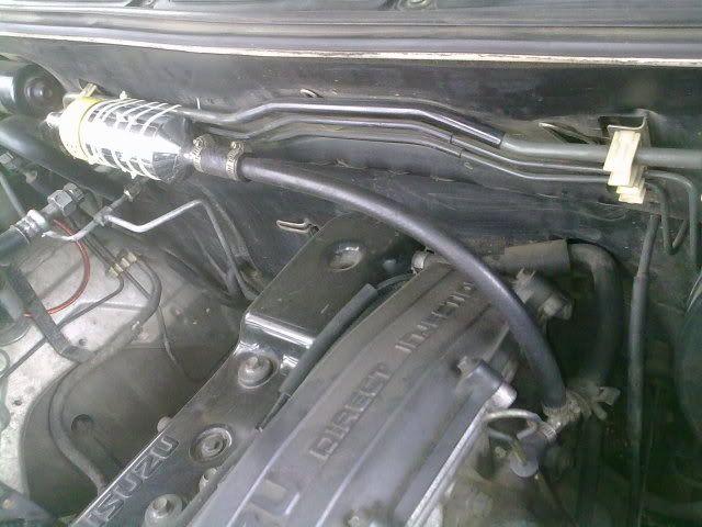

Photos you have posted do show the oilpan and part of the transmission. The neophyte in me says it's not a leak in the oil pan per se but the oil may just be "crawling" to it.
Best to have your car lifted and have the underchassis thoroughly cleaned. That way, you'd be able to trace (and determine) where the oil leak is actually coming from.

March 24th, 2011 01:50 PM #1162A cleaning (pressure wash) as recommended by Benzmizer, is mandatory before going any further.
My guess (not good enough, though!) is that the rear engine oil seal is leaking.
Check your engine oil level more often until you determine the source of the leak.
Please let us know what you find, so that we can all benefit.
