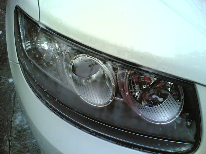

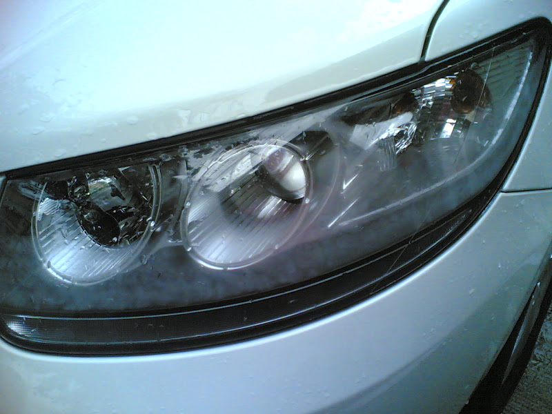

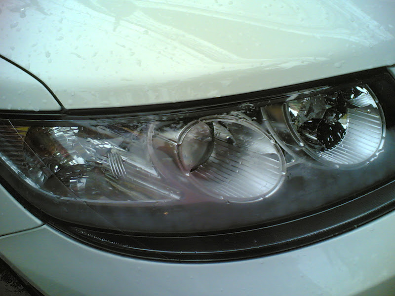

    Latest feedback from Abad santos..
    Ayaw daw pumayag ng HARI ireplace yung headlight IF NAWAWALA NAMAN DAW ANG MOISTURE after a few hours....
    They will replace only if nag-overnight ang moisture sa headlights namin.... WTF!!
    anyway, I'll try to contact you na lang sir C190 later on your advice... Thanks...

    Quote Originally Posted by Innova_Boy View Post
    WBR,
    Not to discourage you or to condone HARI's obstinate and reticent behavior....
    But....
    Usually, this (the appearance of moisture) is quite normal for newer vehicles with plastic headlights lens. It occurs once in a while on our 2006 CRV 2.0 and 2006 Fortuner. I have also seen this on some vehicles being tested by Top Gear, which incidentally included a 2005-06 CRV 2.4li among others.
    The "moisture" is more likely to occur during rainy conditions, esp. if you used the headlights. Or even sometimes the engine heat gets inside the headlight assembly. The cooler outside temperature and the higher inside temperature bodes well to create condensation, albeit, a temporary one.
    Unless, there are large beads of water forming inside or the moisture doesn't seem to disappear after a few hours (3 to 4 hrs) then is really no cause for worry.
    Toyota indicated something like this in their manual. Nevertheless, I wanted to have my Fort's pair of headlights replaced under warranty and luckily the Toyota dealer that I brought my unit to didn't know anything about the "warning" indicated in the manual. However, they didn't replace it immediately though, just the lens first, "daw". Had to go back the second time with pictures this time, before they replaced it with a brand new pair of headlights. Btw, the moisture still does occur once in while but to a much lesser extent than before.

    Quote Originally Posted by stafeyer View Post
    Good day Sir Innova Boy. Nung nabanga po yung right side headlight assy ko three months ago, pinapalitan ko yung buong assy sa insurance. Casa installed a new and complete headlight assy. The day after, I noticed a lot of moisture inside the lens. It was really ugly. Hindi siya nawawala. My suspicion is that the new headlight assy got exposed to moisture and temperature cycling during storage or shipment. Sa inis ko, nagexperiment ako with some household items and to my amazement, it worked! Here’s what I did. I got my wife’s hairdryer and set it to medium hot. I taped a half inch x 1 foot plastic clear hose sa nozzle ng dryer. I then opened the caps for the bulb connections found at the rear of the headlight assy and inserted the hose there. I then pumped hot air sparingly through those openings. Right before my eyes the moisture started to disappear. In about 10 minutes of blasting hot air, all the moisture was gone and never to return. Remember to close those caps tightly afterwards. Hanggang ngayon crystal clear pa rin ang headlight assy. Try it. I hope it solves your problem. Enjoy the ride and drive safely po.
    You mean to say sir stafeyaer, since last 3 months na ginawa niyo by hot air, hindi na bumalik yung moisture EVEN ONCE?? kakabilib naman talaga yan, actually meron na nagsuggest sakin niyan pero no time yet to do it....

    Good day po Sir! Honestly, I would suggest that you inform your CASA about the recurrence of the moisture build-up on your headlights and insist on having it replaced. Show them the pictures that you took and tell them na paulit-ulit na nagkaka-moisture na. If they still don't want to take action, go direct na to HARI. Kase naman diba po, you are not getting your money's worth pag ganyan. Lagi kayo nag-aalala baka isang araw na lang hindi na umilaw yung headlight dahil sa moisture build-up or di kaya tuluyan nang pumasok ang tubig sa loob.
    When I got my SF the first time, nagkaron din ng moisture build-up sa right tail light. I immediately called the attention of my SA. She told me to get pictures of the moisture so that they can report it to management. She said, if the moisture persists, they will replace the tail lights no questions asked, ASAP. Pero awa ng Dyos, hindi naman umulit na yung moisture kahit na nagpapa detailing man ako or carwash up until today.
    I hope na mabigyan na po yan ng sulusyon at matulungan na kayo ng CASA or follow na lang muna simple remedies just like Sir Stafeyer's suggestion... Ingat po sa pagmamaneho!
    SOme more pics yesterday when i have it car washed...
    Very sad talaga....
    WBR,
    Yes Sir! Ganyan din po yung nagyari sakin. Bagong kabit po yun na right headlight assy. Next day may moisture na ganyan. Up to now sir wala na pung moisture. 3 months na po. Hindi na bumalik. I-try nyo po yung suggestion ko at obserbahan po ninyo. wala namang po mawawala. kung bumalik po baka may opening sa seals at nakakapasok ang moisture esp kung high pressure washing. Good luck po!
