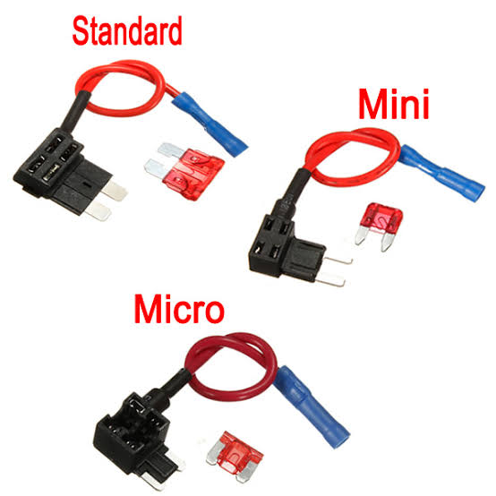

    What kind of fuse tap ang dapat bilhin and saan fuse i-tap?
    Hi sir, use the "micro" fuse tap:
    and tap it on the interior fuse box, location #1 (page 758 user's manual) like I did on post #4767.

    Quote Originally Posted by Tenchi View Post
    This is also what we used, although I'm not sure if it's the standard or micro type. No problem with warranty because there is no splicing of wires.
